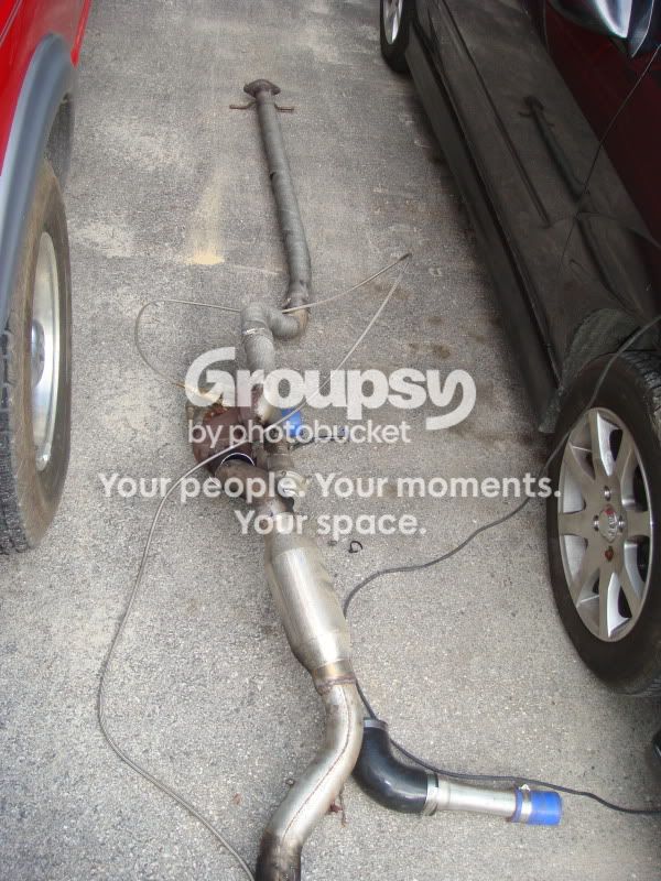

Remote setup on its way out of the car:
Most of the parts being taken out:
The turbo section itself:

If I may offer just one piece of advice. Don't ceramic coat anything. Heat wrap keeps in so much more heat and it costs less. I touched John's manifold right after shutting off the car. Hot to the touch, but didn't burn the skin. John has touched manifolds that were ceramic coated and it took skin off. Ceramic looks cool, but I think wrap looks even cooler. I got the DEI titanium stuff and it's pretty sweet.

^^I may do that, not sure yet. Either way I will probably ceramic coat the turbine housing--I talked to Jon and he advised against using a turbo blanket, not to mention I can't even find one for a T25 footprint turbo like the GT2835. I used heat wrap on previous builds with good results but you generally have to re-wrap it once every couple years.
I'll look into that pump controller, and give FS a call to see if their relay and system ran the pump at 100%. Thank you for the tip.
As a side note, I only observed the charge temps going above ambient when at full boost on a third gear pull. At idle and when driving, the charge temps were within 5-10 degrees of idle--that's why I was thinking it wasn't the pump itself. The ZZP pump controller ramps up to 100% duty cycle at 50% throttle so at that point it would be functioning the same as one hard-wired to be on all the time...Since the temps don't become an issue until building/at full boost, would it make a difference? That's why I was leaning toward me having power levels higher than the heat exchanger had the capability to cool--the charge temps only become an issue at higher power levels than the original FS SC kit were intended for.

this car is nuty, but is there any way to clean up the underhood appearence? i see cables and hoses everywhere,lol.
i know its probalby not too high in the priority list.i jsut theink it'd be that muc hsicker if everything was routed so it looked better than factory.

If you constrict the fluid to much itll actually heat up not cool down, thats one factor in fluid dynamics.

I'll work on fixing the wiring stuff next season probably--most of the stuff is where it needs to be unfortunately but it's all functional. I'd rather own a full-out track car then a trailer queen...The engine bay is pretty dirty at all times, lol...I'll work on fixing some of the wiring because its a potential hazard but that's about it.

Quick update,
Bought some wheels since I'm pretty happy with the performance of the car now--but I did make another purchase from another fellow 'Jetter:
NGR Type S BOV w/recirculation adapter flange. Should sound a little cooler now. I decided to jump the gun and add the secondary spring and vacuum port to ensure that it'll work smoothly at both low and high boost levels and everything in between. I'll post up some clips and whatnot once I get it installed...Hopefully Friday, but we'll see what the weather decides to do.

Update, BOV is installed but no video clips--unfortunately it is pretty quiet but sounds great, thanks jeff--I think the quietness is due mostly to it being recirculated but it's also because it is venting into a pretty thick rubbery tube which probably dampens the sound significantly. I may see if there's a way to put an aluminum tube in its place to make it a little more audible. I'm not like a wrx or srt-4 driver making it go off all the time, but I do like to be able to hear it when it does go off.
