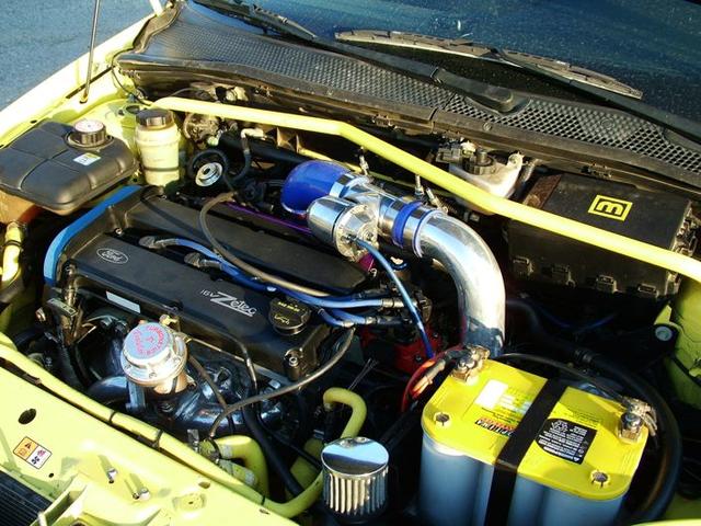

Here is some of the inf0 Karl has given me:
Sure, upgrades are available. What did you have in mind? Remember, our base kit will support 375 WHP without any changes. So you may not need any upgrades.
A few of the components:
Turbonetics T3 Super 60 Water cooled
HKS SSQV BOV
Synchronic WG
2.5" SS Downpipe with WG flex
2.5" Aluminum and Stainless charge piping
3" Aluminum Inlet and MAF housing
Green High Flow filter
Samco 4 ply Silicone couplers
SS T Bolt Clamps
Carbon Steel Studs for manifold
Copper Lock Nuts
Cast Steel Turbo Manifold
Bar and Plate Intercooler
Seimens 60lb Injecotors
The kit will include a disc with base files to get the car mobile, but would still require a tune.
