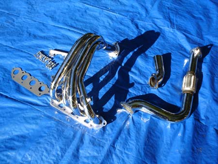

About the header in the original post:
I was browsing around b/c I'm considering getting one myself, and in an old sportcompact car article they ran the Focus Sport 4-1 race header, with a very similar flexjoint/extension pipe combo. What they did in the article was add a small high-flow cat in place of the flex joint, and then I believe they added an o2 bung behind the cat, keeping the car legal and not having to deal with any Mil/CEL problems.
With a header/extension combo thats as cheap as that one can be found for, I see the above as a viable option. Just my 2cents.
That is not technically legal. Now it may well pass a smog check in some locals. It still is violation of the federal law prohibiting removal of the OEM cat.
It's a great solution for folks who want to be environmentally responsible and again it may well get past a local inspection (or it may not) depending on how the local inspection is performed.
Strictly speaking though it is still "illegal".
Emissions are a funny area with cars, there are federal laws but no federal checks, the state and or local checks differ greatly in how they are done if done at all.
Mostly know your local laws.
I've run long tube zetec headers here in SoCal, I was prepared to go back to stock in order to pass smog. I relied on grey hair, not street racing and generally not driving like a douche to keep from having trouble between smogchecks.

True about laws differing & illegality. Mostly I was hoping that with a cat:
A. You wouldnt have to worry about a MIL/CEL.
B. The setup would be a little quieter.

Not meaning to threadjack, but what I'm really looking for is a header/cat combo that doesn't hang as low/far forward as the SVT header does, doesn't have a flange where the SVT header<->cat flange is, and bolts to the SVT exhaust.
So far the fleabay in question fits the bill; its cheapness is all the better for me b/c it's going to get dented/modified anyway.
Unless I've got my exhausts confused and it doesn't bolt to the SVT exhaust

It will bolt up.
The Zetec and SVT exhauts start in the same spot. The differences are in the cat and flexpipe. The SVT cat ends farther under the car and it uses a shorter flexpipe. Both end up in the same spot, it's just how you get there.
If you go with the SVT, it becomes more expensive because you'll need the dipstick and power steering line. I did mine and haven't regretted it, but it may not be the solution for everyone.

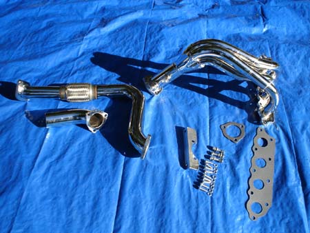

If someone with the 4-1 longtube could please take a couple of pics of how far it sticks past the oilpan & where the lower o2 sits relative to the block/transmission I'd really appreciate it.
These are shots from SSautochrome:
It looks like the collector is sitting nearly level to the pan, but I can't tell. And you can't see where the tip of the o2 is. I'd like to get this header, but I don't want to keep breaking o2s, or rip the collector off the piping, as I'm sitting pretty low.
This is the FocusSport header; the collector is farther back, but the o2s still look dangerously close to the block:

The extra tubing is to have a dump off after the flex pipe. Would be extremely loud. Use for track use only.

Just an fyi, the OBX SVT header has larger primaries than stock in it's description. Can't say what the effect on the performance of the header is.
actually that extra pipe doesn't fit well enough to do anything with.
