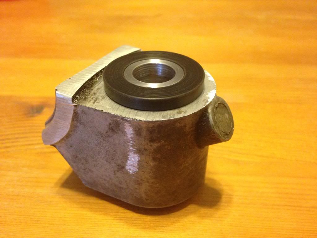

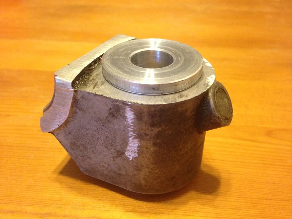

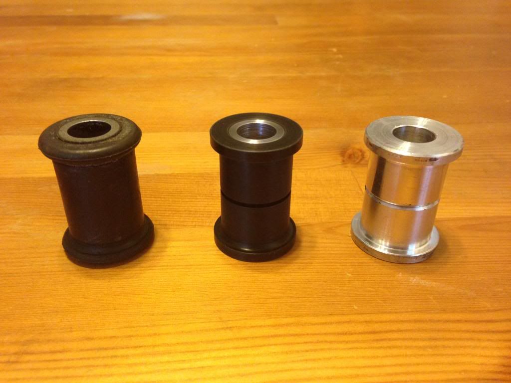

People have been asking around for someone to make solid steering rack bushings, so I figured I would take on the task Well, I went the yard, and beat a rack to death till I got the part I needed aaaaaaand now we have bushings...
They will increase the steering response of your rack, but will take away a little of the sissy proofing on your car. You will feel a little more vibration through the wheel, but gain the extra control.
The pictures show my bushings vs the stock rubber one, and also how they fit in the rack

What is the difference between the delrin and the aluminum? As in, is one better than the other? If so why?

The difference with the bushings is that the aluminum will be the most rigid, but are like solid motor mounts, and transfer all the vibration. The Delrin are much stiffer than stock but still retain some dampening characteristics, and don't transfer as much vibration.
