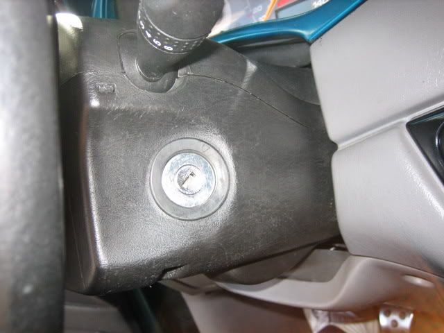

New Ignition Cylinder Help. Now with Pics!!!
Thanks to Steve (FORDSVTPARTS)...he helped me with this a few weeks ago...so I used most of his instructions, and added some stuff. Everybody's had problems with this...and everybody thinks that it is going to cost a ton of money, or you have to drill it out...well you dont...here it is:
1. To replace the cylinder you just remove the column shrouds to gain access to the cylinder, you will need to be able to turn the cylinder to remove it the easy way.
2. If you are having probems getting your key to turn then try the old "hit it with the palm of your hand method". This should be enough to get the key turned.
3. Turn the steering wheel 1/2 turn to the right so that you have easy access to the lock cylinder, and some working room. With the key turned to the "on" position, there is a small hole in the housing, that the cylinder goes into, that faces towards the driver, Use a small pick or philips screwdriver or whatever will go in the hole, push in the release pin inside the hole and the cylinder slides right out.
4. If you absolutely can't turn it you will have to drill it out or take it in somewhere and have the job done.
5. Once the old cylinder is out the new one slides in by aligning the "d" shape inside and it will now work, Thats it.
Note: Most dealerships will build the cylider to match your keys, some charge for this and others don't. Just call the parts department, give them your VIN...and they can look up your Key Code, cut you a Non-Programed PATS key, and build your new ignition cylinder off of that. Or you can take them your programed key (if you have a spare). If you are like most if us that leave your key in the ignition once you start having this problem...DONT TAKE IT OUT. This will help you in the removal of the broken cylinder. Hope this clears up everyones questions.

you can have any of the parts guys at the ford dealership set the tumblers for your key. You should be able to jar the ignition loose by putting the key in the ignition and hitting the key with the palm of your hand a few times. you only need to turn the key that one time to get it out. If you cant get it...then the job does get a little tricky. You will have to drill it out. I dont really have an answer for you on the slide hammer, as I have never done it...but I would try to get the ignition cylinder loose by the method I mentioned. Good luck...if you have any more questions...feel free to send me a PM and I will do the best I can to answer them.

oh yes,im glad you posted this because im about to hit my 3rd lock ign. cylinder:rant:
so i appreciate the instructions with photo's:thumbup:
