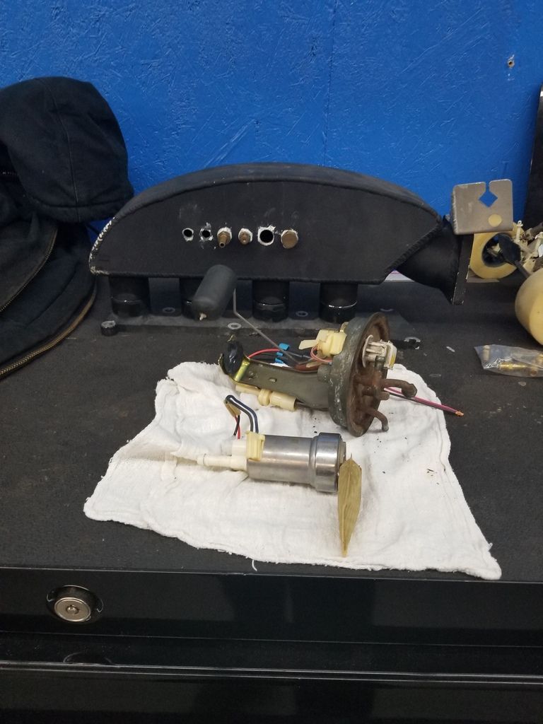

Fast forward to Spring 2018 and I am really getting tired of barely moving 30 #/min. I came from a 550+ whp DSM that moved over 56 #/min, so naturally someting had to be done. I had plans to get the T3 manifold from FSWerks and do some custom plumbing, but then Chris over at Top Speed ended up listing a cheaper turbo kit they had in the works for sale. I was weary of the SPA turbo it included but I couldn't say no at the price we ended up at. I also bought a two piece intake manifold from him off the race car. The fuel pump is an E85 Walbro 450 that came out of my sheclipse. I was debating going return fuel, but for now I am happy with where she is.
Chris told me he was going to make a new MAF tube for me to better fit the manifold I had purchased from him. Per Top Speed's usual customer service it ended up taking a month to get the kit to me. Upon opening the box, I noticed that not only did it not include oil lines as I was told, but there were no clamps, couplers and I was shorted an air fitting for the wastegate. So there goes $500 on top of what I paid him for the kit. It's always the little stuff that piles up in turbo builds. Once everything came to me I was ecstatic and could not wait to get the kit on.
Lucky me my boss was taking a weekend trip with the fam and I had the shop to myself Fri-Sun. So I ended up taking all day Friday to install everything. Literally. I was there at 8am and didn't get home until just after 8pm. The fitment issues I ran into with the intake manifold really screwed me, but when everything was installed and I turned the key and she fired up on the FSWerks tune I was PUMPED. Oh...and I might have gotten a killer deal on some 245/40s to put on the 17x8 Advanti I traded the CR7s for........
Don't mind the dirty bay...when I update the CCV setup the PO installed I'll clean it up a bit and probably throw another 45* pipe on the intake to push it away from the engine a bit. For the next week after I got the kit on I ran into nothing but problems while tuning. For some reason the PCM would not read open loop. I started over like 4 times and every single time closed loop was perfect. As soon as I would go wide open it would stay closed loop and not deliver any extra fuel, which is no bueno. I also noticed I was reading 750 counts on the stock MAF at part throttle. Big shout out to the Sporadic focus build, I copied him and picked up some ID1000s and a BA5000 MAF from SCT.
Magically the first tune I wrote after install of the new injectors and mass air she went open loop and my STFT showed my commanded lambda. I couldn't have been happier. I spent the entire weekend fine tuning closed loop and adjusting the MAF Transfer Function for open loop. On 12 psi she was moving 34 #/min. On 12 freaking psi. Turned it up to 15 and while the average was 37 #/min, she did read 39 at one point. No more falling off like the GT28RS did, this little SPA turbo holds power all the way to redline. She is a completely different animal and I love it.
